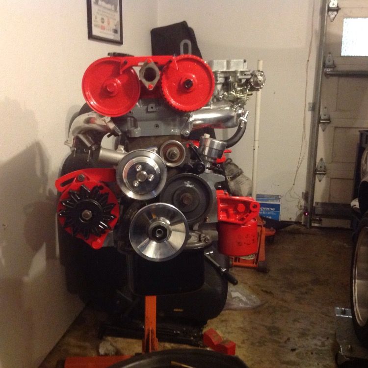

Just picked up this 1975 basket case a month ago and started putting it back together. Body is pretty solid, just a bit of rust. The motor looks to be in decent shape so far. Head is in decent condition; the block got a little water in it but cleaned up decently well. I have high hopes to turn it into a runner soon. I also picked up a 2.0L and was thinking of swapping the 1.8L head onto the 2.0L block. I'm wonderinh what challenges I'l run into. Looks like I can transfer the exhaust side alternator brackets pretty easily. I'm wondering if the motor will sit too high to close the hood? I will have to reuse the 1.8L motor mount brackets and motor mounts.
First order of business was to pull those clunky tube bumpers off. I think the vehicle raised an inch once I pulled them off!

I've never seen a tan hardtop before, only black. Very cool.
There are quite a few threads on doing the 2L swap, I'm sure someone has spelled out any issues with getting it to fit right.
There are also shorter engine mounts available through some vendors, which would help with any clearance issues.

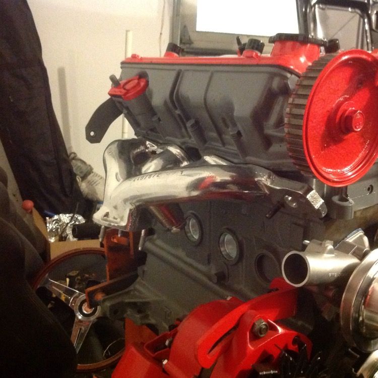

by Ptoneill
The 2.0 swap should be no problem, keep your 1.8 head, I had a new set of performance cams placed in mine. I moved the alternator to the exhaust side of my 2.0 without issue, Miller Mule makes a heavy duty bracket ( the old ones tended to bend) and a mounting block for the OEM alt or the 95 amp Ford alt. Also stay away from the OEM 79 carb it is inefficient and there are numerous replacement options to be found on the forum.

Ptoneill wrote:The 2.0 swap should be no problem, keep your 1.8 head, I had a new set of performance cams placed in mine. I moved the alternator to the exhaust side of my 2.0 without issue, Miller Mule makes a heavy duty bracket ( the old ones tended to bend) and a mounting block for the OEM alt or the 95 amp Ford alt. Also stay away from the OEM 79 carb it is inefficient and there are numerous replacement options to be found on the forum.
Question: Why would you move the alternator to the exhaust side? I would think that by keeping it on the driver side it would get less heat soak from the exhaust and also have cleaner/shorter wiring.
I did mine primarily for looks, I have Marks Computronix's ignition which mounts on the front left of the block below the alternator. It is a cool piece of tech that I did not want to hide, by moving the alt to right it "balanced" the look of the engine. As for heat, heat rises so that helps and I had my exhaust ceramic coated, hopefully it is not an issue.
