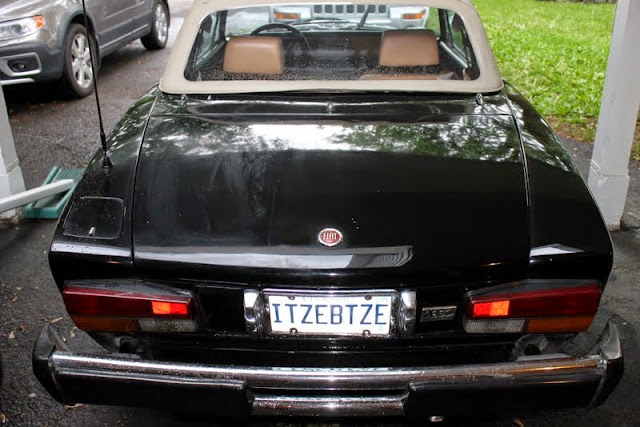

clay bar makes a huge difference (see right side)

I read your thread before posting mine. I started with the bar clay and couldn't notice a lot of difference and so I thought I was doing something wrong. thanks for the post.
