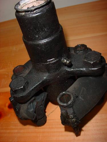

Because of the rotation of the engine, the only thing I could think of was the flex disk, or doughnut as it's affectionately called.
Sure enough, I got up under there and felt around and an entire section was missing.
So off with the support brackets, off with the brake springs, and off with the bolts at either end of the driveshaft (interestingly when I took the shaft down at the differential end about 2 tablespoons of oil ran out. Anyone ever have that happen??)
I got the flex disk out and here it is in all its glory...
I think a little expansion foam in there and it will be good as new....
Yeah right.
