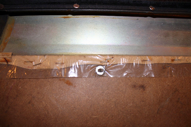

Why do you need glue? I think the vinyl is stapled to the board.

vandor wrote:Why do you need glue? I think the vinyl is stapled to the board.
Just staples? Well that is interesting. I'll comment more when the time comes. I'll document the whole process.
