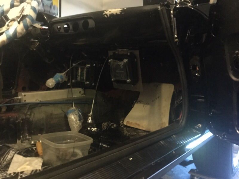

So I have been working on other house keeping issues, I have started to put in the Dynamat. It is not hard but it definately makes you sweat rolling it out!
