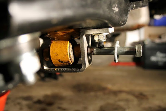

Jay,4uall wrote:You mean this photo?
did you try assembly them in reversed order ?
first the shock to the stand, unfit to the A arm, and then the stand to the arm ?
I'm pretty sure it would fit on the side you show us on the photo, but maybe on the nut side it will we more difficult.
or did you try an allen head bolt, as they are smaller than regular ?
have the opposite nut being welded on the opposite, prior to anything, so you don't have to worry about it and you then just work with your allen bolt.
Am I clear on this ?
I put it is french in case
tu soudes ou fais souder l'écrou qui va recevoir le boulon, côté gauche de la photo (invisible)
avec cette solution, l'écrou occupera une place minimum.
tu utilises un BTR (boulon tête ronde) au lieu d'une tête hexagonale pour l'axe inférieur d'amortisseur. La tête est plus petite et passera sous le goujon (que tu peux néanmoins raccourcir un peu). Il te faudra simplement prévoir une rondelle grower côté boulon, car tu ne pourras pas mettre un nylstop (ne résiste pas à la soudure).

Thanks/Merci I did try and it makes no difference as the nuts of the mounting threads touch each time. Do not have the resources to weld. Thinking these products should work without modifications etc. Going to use the original shock mount (the one that did not fit the shock see above post LMFAO!).
