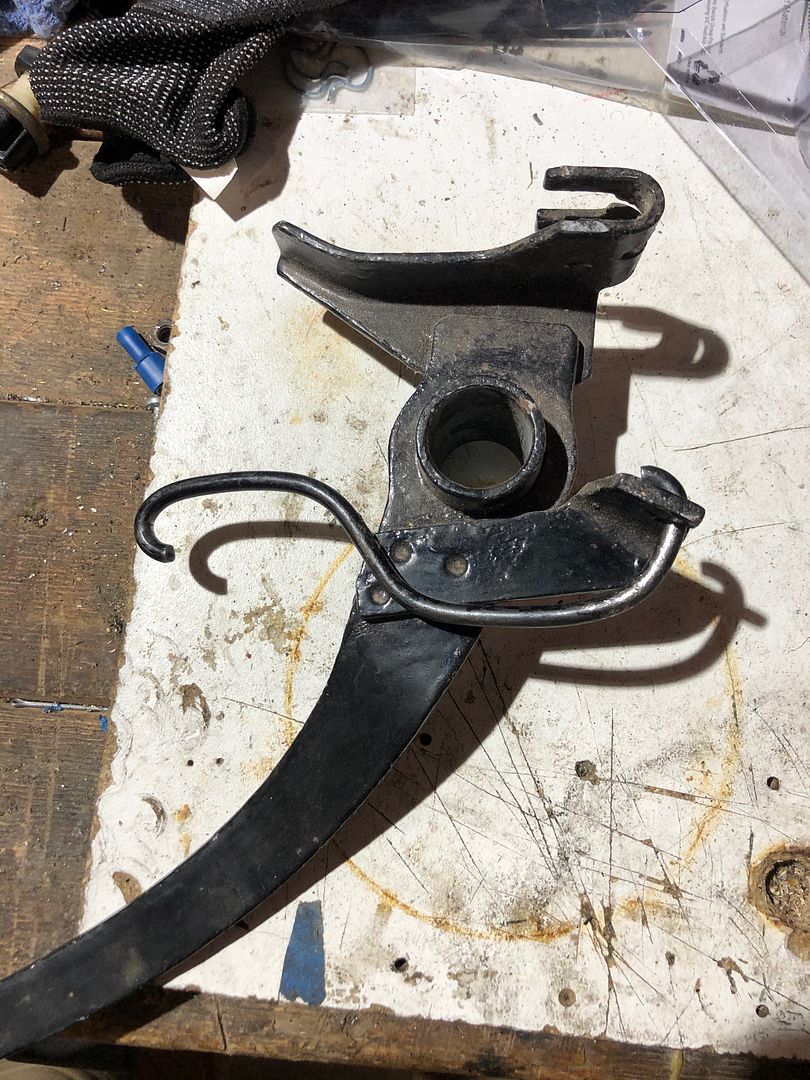

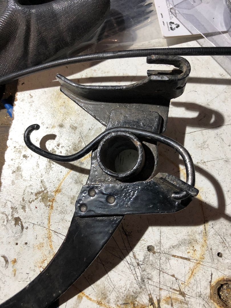

Just to illustrate my clutch pedal question (maybe I've just solved it?) - here is a spare clutch pedal and the hook which attaches to the pedal return spring. You can see the axle/shaft that the pedal mounts to. The workshop manual clearly shows the hook mounting over the top of the shaft (first photo). However if you depress the pedal, the angle of the hook and the shaft means that there is a cam effect which causes the pedal to sink to the floor. The second photo shows the hook reversed - is this the way I should mount it? It's tempting to drill a whole new hole in the pedal slightly lower down just to make sure but I can't bear the thought of taking the pedal box out again...

Ahhhh, the infamous clutch spring! Behold, this shall indeed test ye wits and strength, and whether ye be of bone and muscle, or mere fluff (for lack of a better word).
Actually, it's not a clutch return spring. It's a "help the driver push down the clutch pedal" spring. So, the installation as shown in the manual is correct, and this spring should pull the pedal to the floorboard when nothing else is attached. Seems counter-intuitive, I know. The clutch fork/throwout bearing on the clutch plate and the outer spring from the fork to the transmission are the ones that actually pull the clutch pedal back up.
