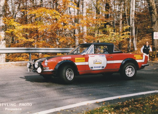

ex ufficial car Tominz-Mamolo female european champions '71

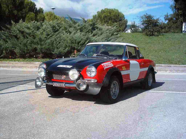

4 Regions Rally 1972 (Paganelli-Russo) WIN !
