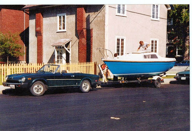

here is the pulling potential
So in June 1985 my Dad sold his boat. The guy who bought came to pick it up in his Fiat. What are the odds?

Didn't read the old post, but..... Hitches have two components, ball or tongue weight ( how much downward force the tongue of the trailer (with max load) puts on the ball of the hitch. Second is towing class ( I.e how heavy is the load that you are pulling, 500lbs, 2000 lbs, 5000lbs) the class of the hitch determines the size of the ball and mounting points to ensure safe towing. Third, related to this is making sure your vehicle has then braking and suspension capable of handling the towed object. As you can see in the picture of the spider and sail boat, the car is heavily weighted toward the rear and probably will have under steer problems over any distance( lifting the front end off the road at bumps and so forth). I have a class lll hitch on my Dakota good for 500lb tongue weight and 10,000 lb towing capacity. It's attached to the frame of the truck and is constructed of 1/4 in x 2 in steel tubing. My bumper ( mind you this is a v-8 quad cab 4x4) has a tongue capacity of 150lb and 1500 lb towing capacity. Ever wonder why you see so many pick ups with mangled rear bumpers.............
Not sure the weight of your boat, but if it weighs more than a couple hundred pounds, I would be thinking twice, even for a parade. Bumper and trunk floor don't sound good. Bumper and frame.... Maybe
