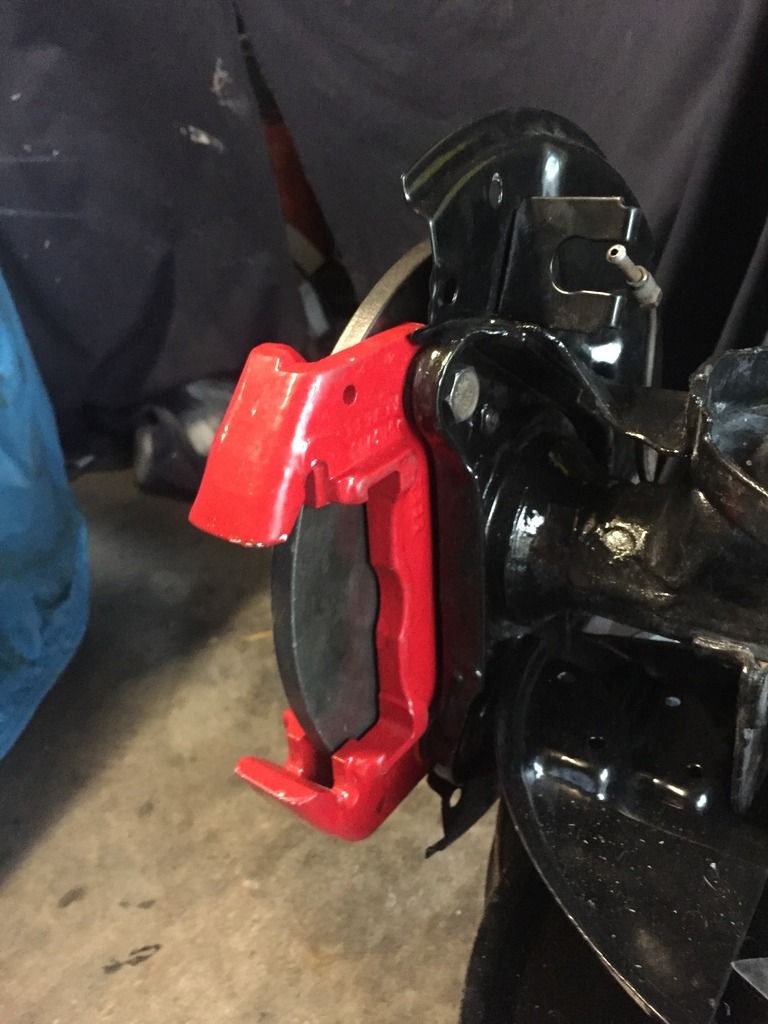

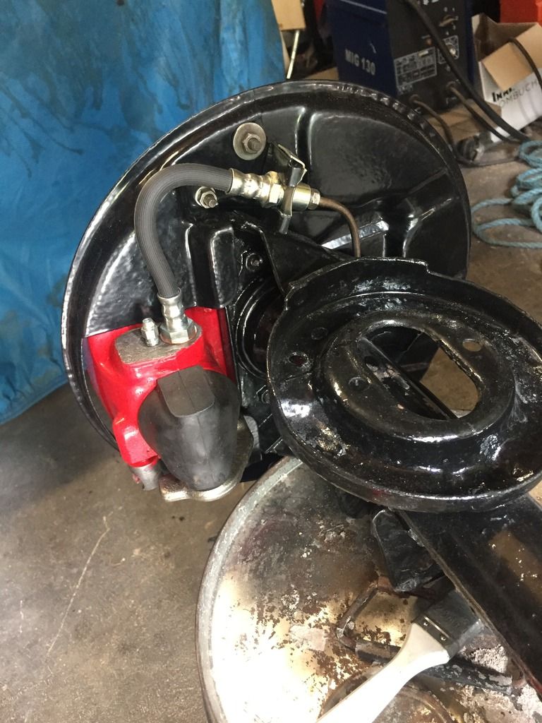

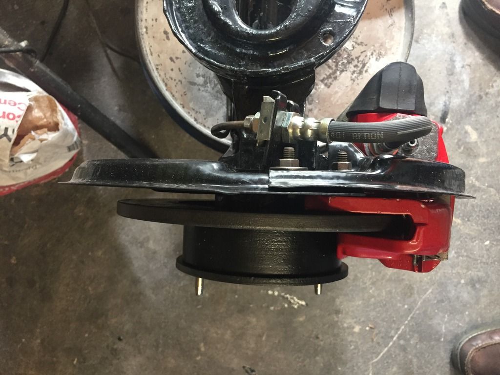

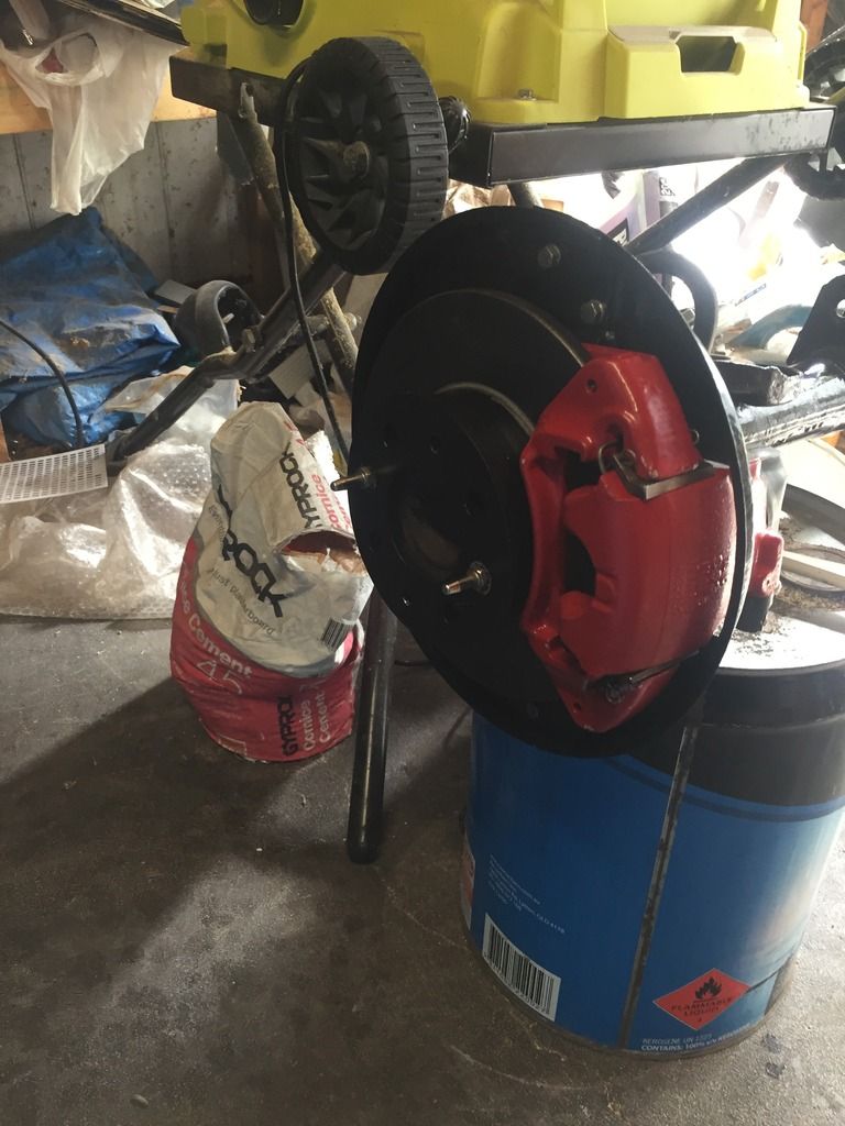

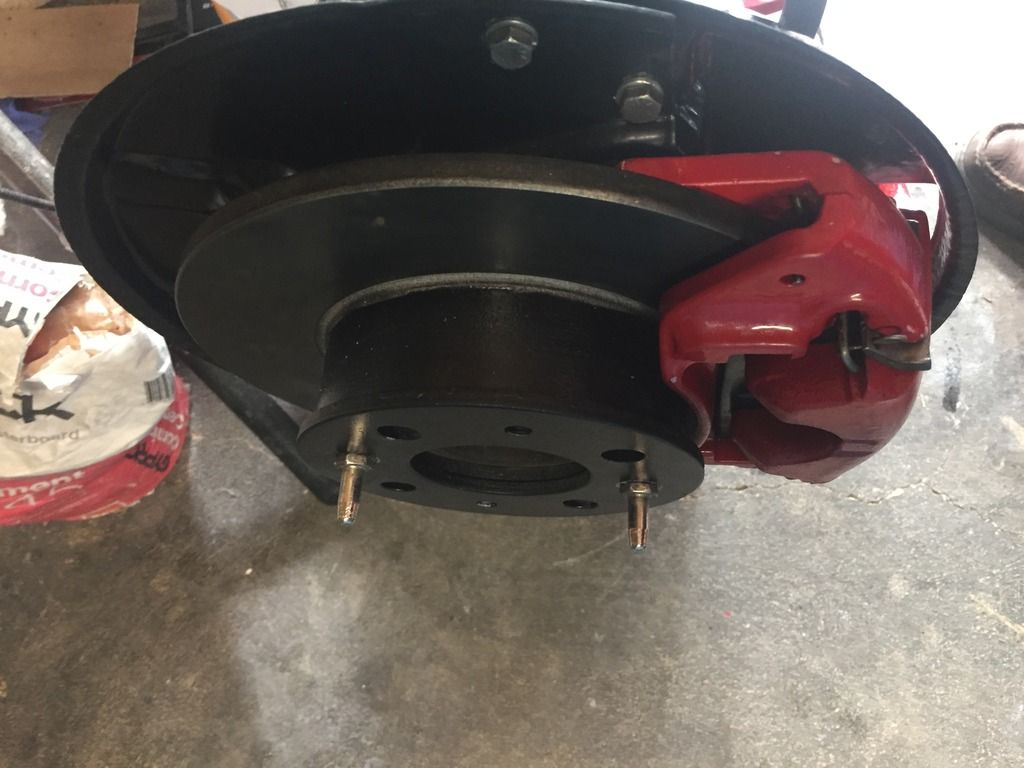

Just a quick update. I've finally got the axle finished with brakes installed and the brake compensator in so I can get the brake lines installed properly. Now moving on to the boot/trunk with the plan to start at the back and move forward. Have wired up the licence plate lights, the right rear light cluster and the right rear indicator.
So a couple of quick questions: 1) where can I get light bulb holders for the side indicators? and 2) what have people been doing to restore the rear light clusters once the chromed plastic starts flaking off?
