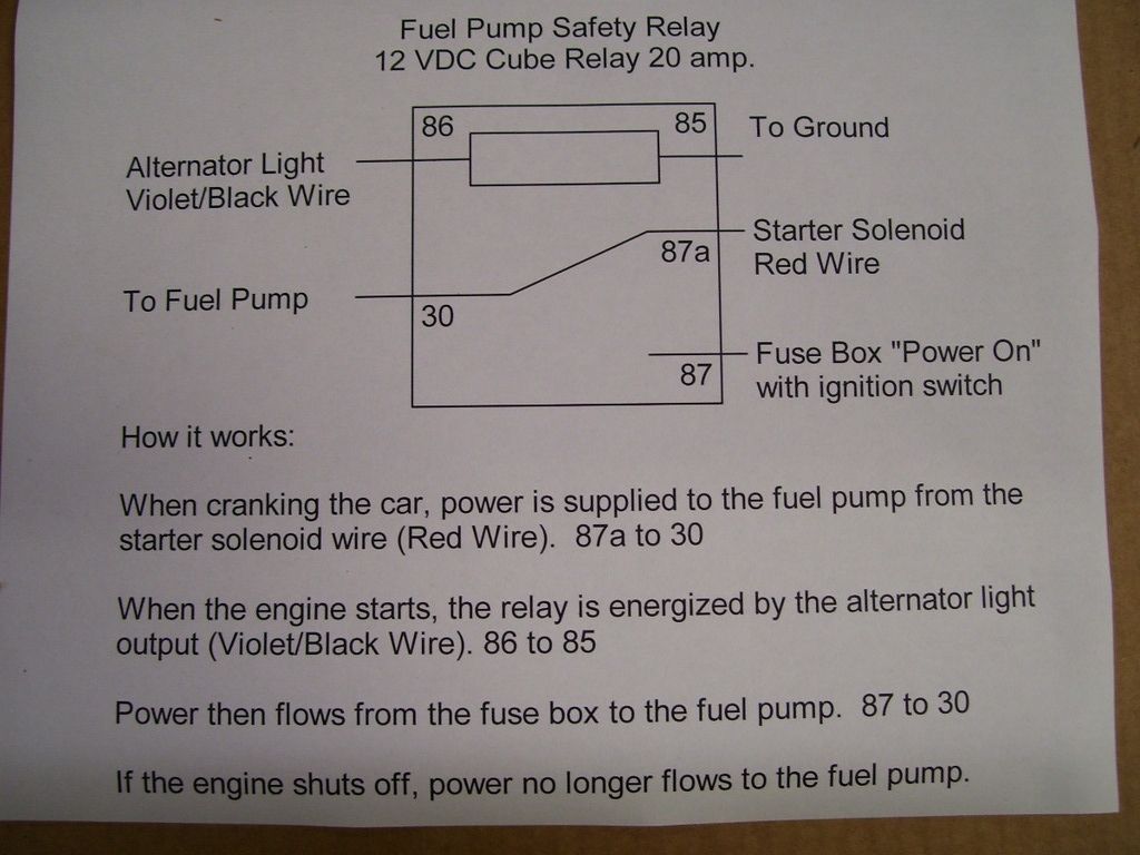

Facet list a fuel pump kit FEP42SV (Cube Pump in kit is 40104) for Fiat Spider years '74-'82 non-fuel injected. CarQuest stocks this kit under their part # CFP41501 and it's normally a store stock item. When I replaced mine, I also installed a relay that only sends power to the fuel pump when the car is being cranked or is running. If the engine shuts off, so does the fuel pump.

thanks, Csaba, that is useful info. The relay is a nice idea, though I could imagine perhaps charge circuit issues fouling it up? maybe? is that the way the '74 original fuel pumps were wired with a relay? My intention to the same effect is to grab a couple handfuls of Ford family fuel pump inertia switches next time I am at Pull-a-Part

The electrical circuit shown above using a cube relay to power the fuel punp is working great on my '79. I did make a bypass rig that has a toggle switch and a inline 10 amp fuse, I just unplug the relay and connect the bypass to socket #30 and #87 if needed. While reworking my car I did add a bolt through the factory ground point, two additional ground straps and three 12 gauge ground wires to the three ground pods (my alternator light is flicker free).
