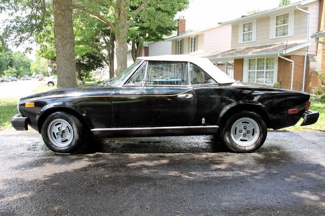

I purchased a 1973 124 spider .The previous owner has installed a set of Kyb gas-a-just ( which is the stiffer set of the kyb series for the 124 ) a couple of years ago .The car seemed to me as it was taller than other 124s that i am seeing .
Checking some photos of the car just before the install i noticed that it wasn't just an impression the car was lower before .
Is it possible the ride height to be increased after the install of a stiffer set shocks .
A mechanic told me that installing stiffer shocks may hold the car taller .
Is it so ?
I thought that only thicker springs or additional spacers may increase the height .
